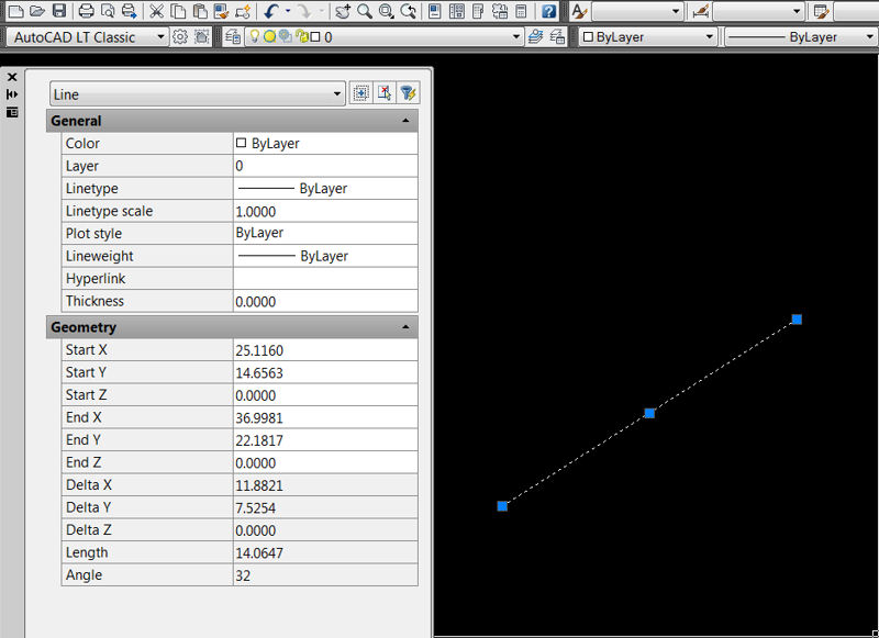

Is there any way to retrieve the DELTA X & DELTA Y values for a simple line.
I know you can get them from ID and by use of a FIELD. What I really need is their separate numerical values, (X divided by Y gives the slope - eg 1 in 20) for use in a macro.
I'm not sure how you can retrieve this data with LT.
The data is on the properties box. Not sure macros run in LT, I know Lisp does not. I wonder if you can put the formula in a field.

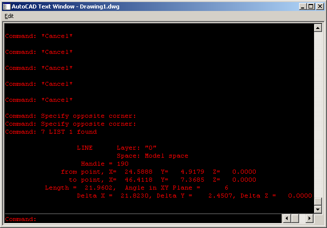

LIST will also display the information...
[ATTACH]19433[/ATTACH]
That is what I was thinking of. Only thing is that needs to set the accuracy of output, out will only give out in intergers.
Wm.
Wm.
That's just a matter of setting the precision(s) in Units.
