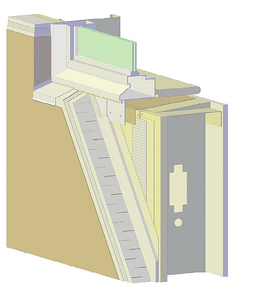

I have changed the edge colour to 7 (white) and have tried to change the lineweight for the #7 pen to a heavier value, and it makes no difference. It seems curious to me that the edge effects panel is disabled (greyed).
P.S.: how do i post a pic in this forum?

What's curious to me is that this has nothing to do with a low resolution PDF.. did we take care of that issue, and now you want to get back to the other post regarding your isometric cutaways? or am I missing something?
You changed edgeline widths with no apparent effect. So make them ridiculously wide and see if there's really no effect, or it's just not real noticeable.

The fact the colors are "washed out" was, I thought, an option you were pursuing on purpose, since your other posts about the detail suggested a requirement that they be faxable.. if the colors were darker, they'd appear black in many fax machines (which only show black or white, with poor handling of anything in-between).
So I'm assuming now that you assigned darker colors and now they lightened? but is that a scan of a printout, or a screenshot of CAD, or a screenshot of the PDF's you got working in True view, or a render to file? Each would have their own "fixes" dependent entirely upon how you were arriving at that image.
As for low resolution, I don't know, for internet viewing that doesn't look bad at all. It's a little difficult to see how the closest wall surface is layered, but if that's not your focus, that's not an issue, nor is it a low-resolution issue. Everything else looks clear and distinct to me.. so it might depend on how you were telling it to print the PDF (assuming that's what that image came from) (ie- web-printing is lower-res than print-out printing, if that's one of the options you're encountering)..

...The fact the colors are "washed out" was, I thought, an option you were pursuing on purpose...
I've abandoned trying to serve the site-guys as well as the sales staff with one detail.
The colors shown on the posted image were set through AutoCAD as color-dependant assignments to layers. Merely my first attempt at a solution. I found it difficult to get any passable result with this method...which surprises me because I have seen decent colored elevations produced through AutoCAD before. Mind you they were plotted to paper. It seems the crux of the problem is in attempting to plot to PDF.

...As for low resolution, I don't know, for internet viewing that doesn't look bad at all. It's a little difficult to see how the closest wall surface is layered, but if that's not your focus, that's not an issue, nor is it a low-resolution issue. Everything else looks clear and distinct to me.. so it might depend on how you were telling it to print the PDF (assuming that's what that image came from) (ie- web-printing is lower-res than print-out printing, if that's one of the options you're encountering)...
Surprisingly, some of the best results I've had of late were using the PublishToWeb JPG.pc3 emulation, with the resolution cranked-up.
...If you shrunk it down in photoshop (or GIMP a free equivalent) now, you would gain some resolution (if you told it to), and you could aslo darken it there if that's what you want, and use "find edges" to create a new transparent layer that you could apply as a filter to darken the edges...

That resolution is not neccessarily the resolution you're having a problem with. the form of resolution you're taking issue with seems as though it's based on the overall washed-out appearance, as you call it. There are subtlties missing from the final image (when compared to your screenshot in the PDF) that appear to be a function of the original darkness of the image.
Looking through your settings.. I'm wondering if the colors lightened because it thought it was going to save you ink when you went to print it? I know that's absurd, but it's the only thing I can think of. I used to have ink saver protocols on my printer that would seemingly "autobleach" everything.
Regardless of the cause though.. I suspect that if you played with it in GIMP for a little bit, you'd be pleased with the results.
