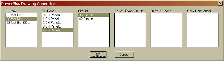

Now I am having trouble adding 2 more list_boxes for my selections...
Let's call them "color" and "condition"
A little shove will be appreciated.
:wink:
Would you mind commenting this out a bit so I can get a better understanding of what is going on here. Not real clear, I am quite new at this.
Thanks...
-SlimP
I have worked on this for hours, and cannot get the hang of it...
Attached is a version I am trying to get to work.
When I replace "Make" with "System" it loads and gets no errors, but the list box for System does not populate!
Please take a look and see what I am doing wrong..
Thanks
-SlimP

Thats odd because it is populated for me. I did not have to do anything to it.
Sometimes you should close down acad and start up again and reload the program.
I did find this however:
The red "e" on the end of system in the alert.
(alert (strcat "You have Selected - " system[color="Red"]e[/color] " " Model " " Year))

Having trouble understanding adding selections from the list_boxes...
Not quite have the hang of it yet.
Can you give me a hand here?
I think you can see what I am trying to do.
-Slimp
Example-system2.lsp
Example.dcl
An example for you to mull over :)
Save DCL to Search Path, type "test" to invoke. :)
