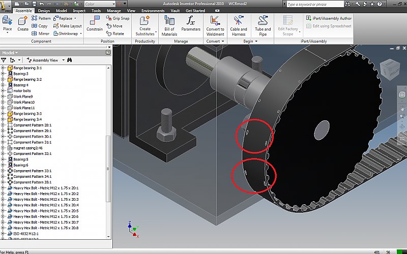

chemicalboy Posted May 4, 2010 Author Posted May 4, 2010 hey guys i followed the feature pattern by making holes on the belt and it worked well along the belt sketch path,but the problem is when i tried to make the same pattern for the component that i want to put on the belt and I couldnt follow the sketch path..as I can see choosing curved paths work only for features not for components..I also tried using the associative pattern to make the component go all the way along with the holes but the problem was in the orientation of the component..here's an illustration of the problem.. Quote
chemicalboy Posted May 4, 2010 Author Posted May 4, 2010 also when I made the hole pattern the holes were all vertical which is ok for the horizontal part of the belt but its a problem with the curved part..how can i make them always normal to the pulley curvature?? Quote

shift1313 Posted May 4, 2010 Posted May 4, 2010 When you make a pattern of the hole, there are options for adjusting the feature. You need to have it follow your path and adjust itself. Quote
chemicalboy Posted May 4, 2010 Author Posted May 4, 2010 ok i adjusted the holes and they're normal now,what about the component pattern? Quote
JD Mather Posted May 4, 2010 Posted May 4, 2010 ok i adjusted the holes and they're normal now,what about the component pattern? If you have the holes patterned correctly (you might need to pattern work axis as well) in the part and then use the correct assembly constraints with the seed part in the assembly the pattern-driven component pattern will be correct. Attach your files here if you can't figure it out. Quote

JD Mather Posted May 4, 2010 Posted May 4, 2010 excuse me but what's the difference if i set the assembly browser to a modeling view? At the top of the browser you will see a tab that says Assembly View. (default) In the browser try to expand one of the parts to see the features that created the part - you will see there are no features listed. Now toggle to Modeling View. You can now expand the history tree of individual parts in the assembly browser. Also, while in Modeling View there will be a folder at the top of the browser Called Constraints. All assembly constraints are collected in that folder (this can sometimes be very useful). Quote
