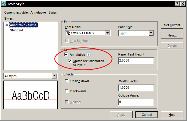

fahim108 Posted May 12, 2010 Posted May 12, 2010 Use an attribute definition instead of plain annotation. First make an annotative Text Style and check the "match text orientation" thingy, I hope you have it in AutoCAD 2007... Type ATT Enter a TAG name (TAG1 or whatever) Enter a DEFAULT value (This would appear on the 'block') Justification > MIDDLE CENTER (This is important) Use the annotative Text Style Place this Attribute over the required object Make them a block (your object + this Attribute) For the "Edit Attributes", that pops up, hit Enter. Done! You may mirror or rotate this block without altering the text direction. :wink: Here's an example... Quote
Pablo Ferral Posted May 12, 2010 Posted May 12, 2010 Ahhh, I didn't realise it worked for mirror as well... Well done Fashim Quote
