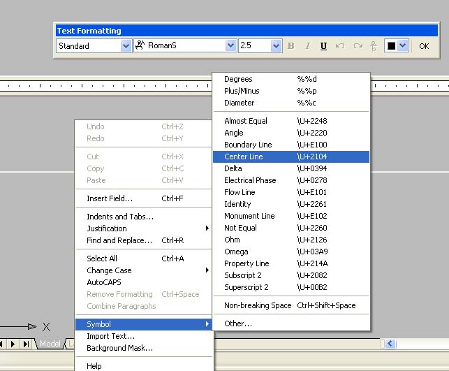

Is there a unicode for centerline. Instead of putting C.L. I would like the L within the C.
U+2104 is the unicode centre line symbol
I type that in and it comes up a question mark, also center line is nowhere on the symbol chart.
Not all fonts have the full Unicode set.
You will have to find a font that has the centre line symbol in it. I found one in a RomanS font.
But for portability of data, you should use a commonly available font, otherwise when you send your drawing to someone else, they will only see a ?
