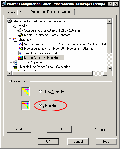

Use this setting while printing and you can have transparent hatches in any cad version. But it's a bit tricky as every entity in your drawing shall disregard any draw-order.
Before applying the setting:
After applying the setting:
