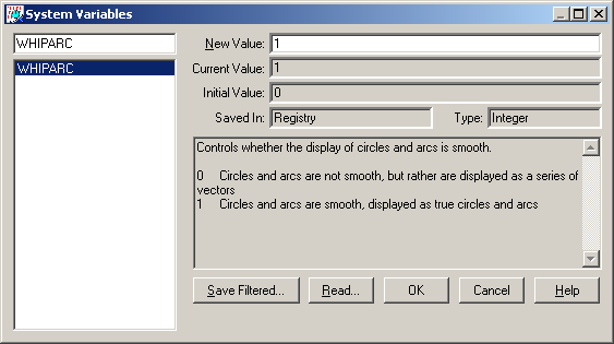

WhipArc will correct plotting problems. I had to fix this in Civil 3D (pipes were displaying at polygons instead of ellipses).
Never ran into that.. good to know, Alan, thanks!
No problem. :) It drove us crazy for a couple days.
