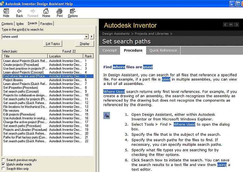

I think there is a technique in Design Assistant to find Where Used, but as I always use a well defined project structure I have never used DA.

Autodesk Vault can help with this. To be honest, I've never tried design assistant. It looks like it may have similar functions. Hope that helps.
