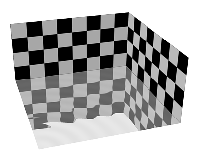

  1. I'm using a checkered backdrop to let you visualize what's going on, you may omit it for your render,
  2. Create a new material, name it WATER, apply it to the region you want to show as water. Using the advanced material type, assign some reflection to the material, render and check...

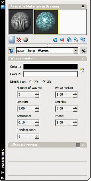

  3. Next add some bump, for this use the "waves" map type as shown, your settings may vary depending on the scale you're working on and your distance from the origin (0,0). Render again and fine tune the settings till you get something that looks like this:

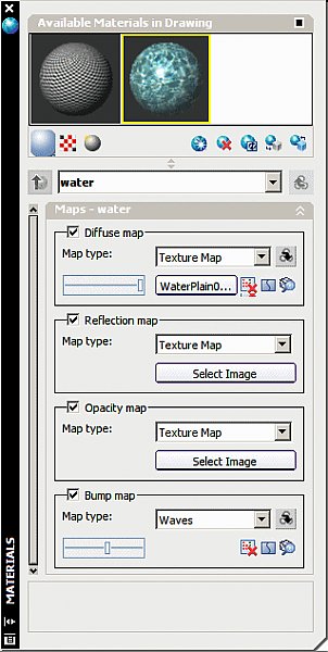

  5. The settings that worked for me

I'm confused.. does the water in your image have a thickness? or is it just a flat plane, reflecting the backdrop?
It came out great, I just wondered because you talked about using transparency, which should have let you see through it, and you made no mention of reflectivity, and yet it appears to be reflecting the tiled backdrop, and actually isn't transparent at all?
...and you made no mention of reflectivity, and yet it appears to be reflecting the tiled backdrop...
Sorry mate! ...my mistake, I actually meant reflectivity. A fair example of bad hand-and-mind coordination!!! :lol:

Are those are standard 2008 menus shown?
Yup! Those are the standard 2008 menus.
what is standard 2008 minus?
They may be talking about the dialog boxes in post #2 item 5.
It means that those menus are what you see when you're working on material settings, if you have 2008. You have 2007.. the technique is the same, but the menus might look a little different.
