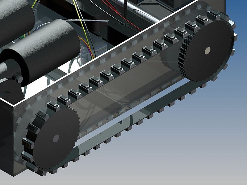

chemicalboy Posted May 12, 2010 Posted May 12, 2010 Hey guys In a timing belt I knew I could only move the pulleys but the belt is grounded so I wanna know if I could somehow animate components that I put on the belt to rotate on its perimeter? Quote
shift1313 Posted May 12, 2010 Posted May 12, 2010 I think in the Joint Creation window there is a Point on a Curve joint. At a first thought I think you might be able to animate the block around the path of the belt but i doubt it will be that easy. Also you will need to rethink how you created those components. In your assembly you have it broken down into 4 patterns for each belt. You need a closed path. Quote
chemicalboy Posted May 12, 2010 Author Posted May 12, 2010 I already modified the pattern into associative pattern to go with the hole feature pattern that i already made on the belt,so now I have only 1 pattern for the components around the belt,I already have a closed path which is the belt's sketch path,how can it be possible to make the magnets move along that path? Quote

chemicalboy Posted May 14, 2010 Author Posted May 14, 2010 I already have that book but it only contains simulation problems with their answers and none of them resembles mine,to shift:I used that point on curve joint and it worked!! but the orientation of the block was a mess,so I made two of those joints for two different points on the block base and it worked pretty well,yet I couldnt do it for the whole pattern,any ideas? Quote

kencaz Posted May 15, 2010 Posted May 15, 2010 There is a new Transitional constraint, however, I'm not sure if it's included in 2010 or just 2011 I only have 09. Garin Gardiner (from Autodesk) had mentioned it on one of his blog videos and it seems interesting.... Here is the link: He mentions it around the 6 minute mark... Basically now you can have a tangent constraint over multiple surfaces... This could solve the problem of getting around the pulley but I'm not sure how you would drive it all the way around. I see a lot of people wanting to do this and it seems that Autodesk should address this, or maybe they have already. Here is the link to his Blog: good stuff... http://inthemachine-autodesk.typepad.com/blog/ KC Quote
