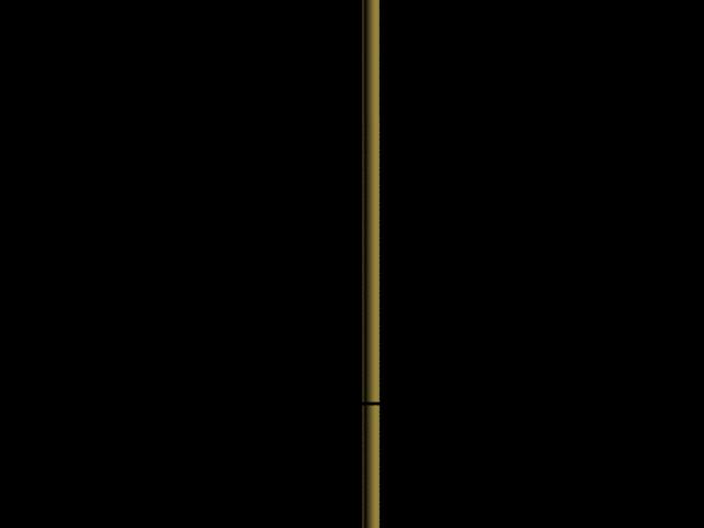

I've created a double helix style object for a wind turbine in my model, but when I render, it will only appear as a cylinder. Furthermore, I have several of these objects in my model, and they were all converted to cylinders in the model space. I was able to revert to a backup file and get the original, but I can't figure out what's going on. Does anyone know how to solve this problem??? Help!

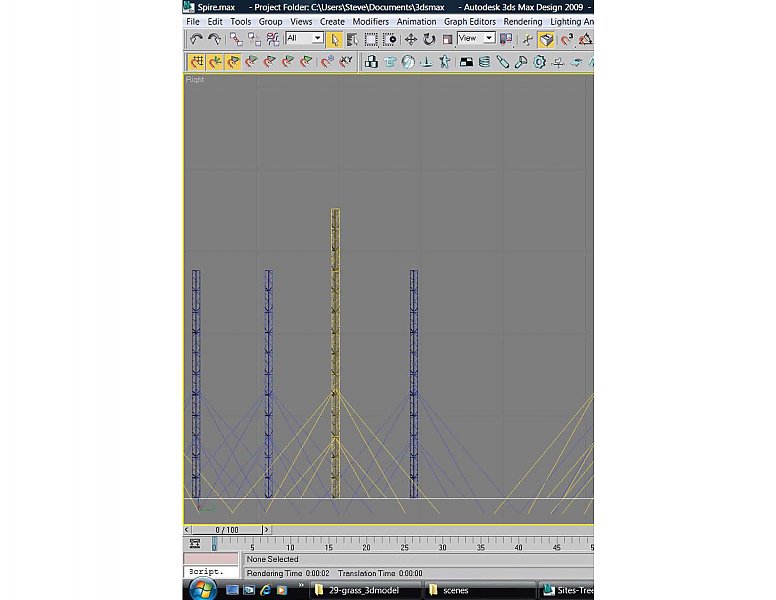

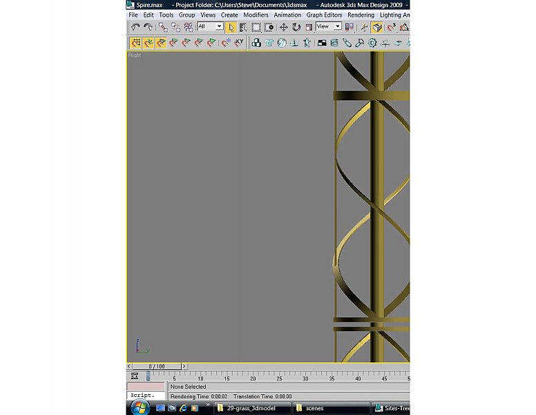

I did get some screen shots from the new file and the rendering is still turning the object into a cylinder. I tried the rendering from several distances and different quality settings, and no luck... Take a look. Any ideas...?

I received your file and upon rendering it, I saw that only the center post appeared in the render. So I window selected the entire model, right clicked and Converted to Editable Poly. After doing that it rendered with no problem.
So I'm curious as to how you created these models. Did you create them in Max? Or did you create them in another program and then Import them into Max? The reason I'm asking is because they don't act like Max models. When I select them, I don't get anything in the Modify panel, and the only way to edit them is to add an Edit Poly modifier. Even after I converted them to editable poly, I still don't get anything in the Modify panel. This is very strange so I'm very curious as to how you created them. :?

Basically, what I did to create them was I used the helix, line, and donut tools and then adjusted the thickness' in the rendering dropdown menu. Once I had them how I wanted, I just grouped them to create a unit, and then regrouped them when stacking. 'Not sure if that's the best way to do it, but I had just started using the program.
