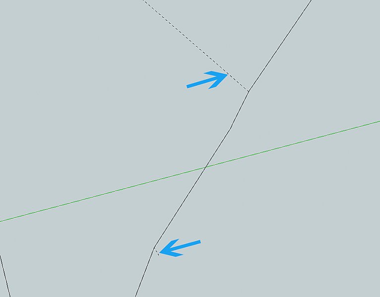

First off you had some hidden geometry that could seriously mess with your ability to do a follow me properly. See first attached image.

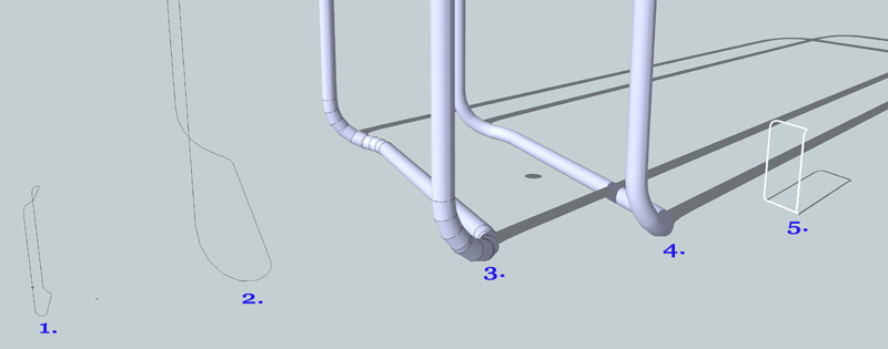

Second, if you do the follow me at the scale you have you will get a broken path like the second attached image. The reason for this is that SketchUp cannot calculate very small areas so it leaves them out. The thing to do is to scale your path and profile up by 10, do your follow me and then scale it back down by .10 Sounds odd but it works.

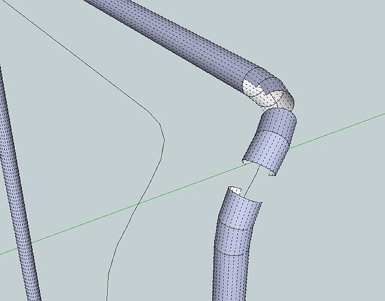

See third attached image for the steps I followed:
1. Opened file
2. Copied the path and profile, removed hidden lines and scaled up by 10.
3. Exploded the path (as it was a group). Selected all the lines then clicked the circle with the "follow me" tool. By doing it this way you don't have to manually follow the path.
Again, select path, click the follow me tool, click the profile.
4. Selected everything and used the "soften edges" slider (Window/Soften Edges). Then I reversed the faces so that the front face was on the outside. This is very important if you are going to use a render engine at any time.
5. Scaled everything by .10
Hope this helps. Oh, and I attached the skp file at the bottom as well.
