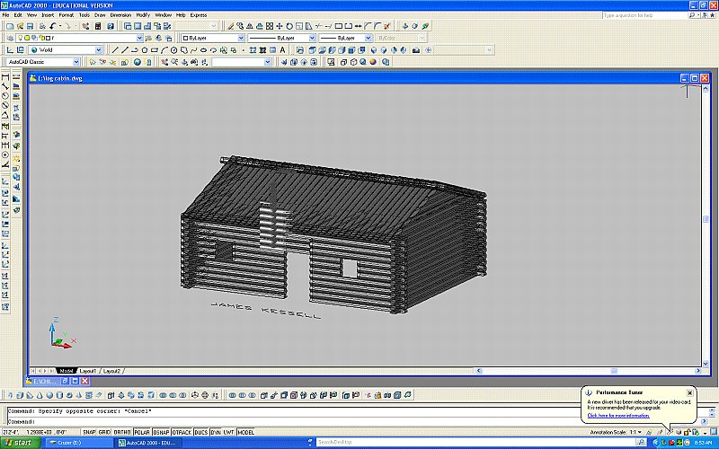

I am a student and having trouble with my drawing and was curious if someone out there could help me ?
I am drawing a 3d solid house and have my shademode set to realistic but for some reason you can see parts of the back wall through the front walls . This has been driving me crazy for a while and my teacher is baffled also . Has anyone else ran into this ?
Check your visualstyles make sure obscured edges visible is "NO"
Also, under your "3DCONFIG" Manual tune settings have autocad reset to recommended settings...
