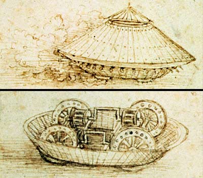

You must be a student of Da Vinci's methods. You will notice in the picture of his "Tank" that the front and rear wheels counter-rotate when cranked. He did not draw it that way because he was stupid.
Not a student of DaVinci but, a fan!
