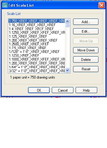

I use ACAD 2008 LT and i use annotative objects in my work. Everytime when i download some xref into my file there always come with xref file so many annotative scales so i have to delete these all the time. Here is a picture of my problem.
Be sure you have the latest updates/service packs...
See here ...you'll need to run the utility on xrefs before you insert them
