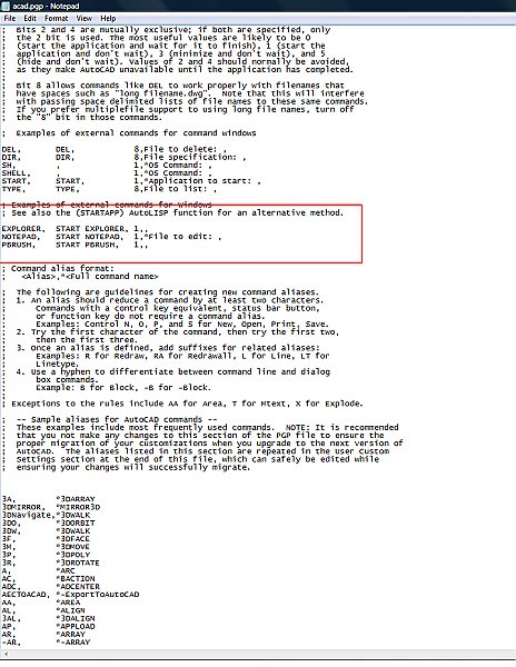

gsksun4 Posted May 14, 2010 Posted May 14, 2010 A co-worker has drawings with notes done in notepad. Easy enough to edit the notes, but how does one create these notes/text in notepad. I'm sure this is a simple one. I typed in notepad at the command line and it says unknown command. Using 2009LT. Glenn USA Quote
alanjt Posted May 14, 2010 Posted May 14, 2010 Assuming LT has Start, add the following to your acad.pgp file. NOTEPAD, START NOTEPAD, 1,*File to edit: , Quote
JamyB Posted May 14, 2010 Posted May 14, 2010 It should already be setup in your ACAD.pgp file. If not, go -TOOLS -> CUSTOMIZE -> Edit Program Parameter Scroll down to 'Examples of external commands for Windows' and add to the list : NOTEPAD, START NOTEPAD, 1,, Then save a quit. In Autocad type 'REINIT', select PGP file, click Ok. Then type NOTEPAD and let me know if this works. Quote
gsksun4 Posted May 14, 2010 Author Posted May 14, 2010 It should already be setup in your ACAD.pgp file.If not, go -TOOLS -> CUSTOMIZE -> Edit Program Parameter Scroll down to 'Examples of external commands for Windows' and add to the list : NOTEPAD, START NOTEPAD, 1,, Then save a quit. In Autocad type 'REINIT', select PGP file, click Ok. Then type NOTEPAD and let me know if this works. You lost me at save a quit. Also, no "Examples of external commands for Windows" list. There is the list of command aliases. Two columns. Ex: 3P, *3DPOLY A, *ARC AA, *AREA AC, *BACTION AD, *ATTDISP AECTOACAD, *-ExportToAutoCAD AE, *ATTEDIT AR, *ARRAY I'm sure you already know this. Quote

alanjt Posted May 14, 2010 Posted May 14, 2010 eg. ; ; ; Program Parameters File For AutoCAD 2008 ; External Command and Command Alias Definitions ; Copyright (C) 1997-2007 by Autodesk, Inc. All Rights Reserved. ; Each time you open a new or existing drawing, AutoCAD searches ; the support path and reads the first acad.pgp file that it finds. ; -- External Commands -- ; While AutoCAD is running, you can invoke other programs or utilities ; such Windows system commands, utilities, and applications. ; You define external commands by specifying a command name to be used ; from the AutoCAD command prompt and an executable command string ; that is passed to the operating system. ; -- Command Aliases -- ; The Command Aliases section of this file provides default settings for ; AutoCAD command shortcuts. Note: It is not recommended that you directly ; modify this section of the PGP file., as any changes you make to this section of the ; file will not migrate successfully if you upgrade your AutoCAD to a ; newer version. Instead, make changes to the new ; User Defined Command Aliases ; section towards the end of this file. ; -- User Defined Command Aliases -- ; You can abbreviate frequently used AutoCAD commands by defining ; aliases for them in the User Defined Command Aliases section of acad.pgp. ; You can create a command alias for any AutoCAD command, ; device driver command, or external command. ; Recommendation: back up this file before editing it. To ensure that ; any changes you make to PGP settings can successfully be migrated ; when you upgrade to the next version of AutoCAD, it is suggested that ; you make any changes to the default settings in the User Defined Command ; Aliases section at the end of this file. ; External command format: ; <Command name>,[<Shell request>],<Bit flag>, [*]<Prompt>, ; The bits of the bit flag have the following meanings: ; Bit 1: if set, don't wait for the application to finish ; Bit 2: if set, run the application minimized ; Bit 4: if set, run the application "hidden" ; Bit 8: if set, put the argument string in quotes ; ; Fill the "bit flag" field with the sum of the desired bits. ; Bits 2 and 4 are mutually exclusive; if both are specified, only ; the 2 bit is used. The most useful values are likely to be 0 ; (start the application and wait for it to finish), 1 (start the ; application and don't wait), 3 (minimize and don't wait), and 5 ; (hide and don't wait). Values of 2 and 4 should normally be avoided, ; as they make AutoCAD unavailable until the application has completed. ; ; Bit 8 allows commands like DEL to work properly with filenames that ; have spaces such as "long filename.dwg". Note that this will interfere ; with passing space delimited lists of file names to these same commands. ; If you prefer multiplefile support to using long file names, turn off ; the "8" bit in those commands. ; Examples of external commands for command windows DEL, DEL, 8,File to delete: , DIR, DIR, 8,File specification: , SH, , 1,*OS Command: , SHELL, , 1,*OS Command: , START, START, 1,*Application to start: , TYPE, TYPE, 8,File to list: , ; Examples of external commands for Windows ; See also the (STARTAPP) AutoLISP function for an alternative method. EXPLORER, START EXPLORER, 1,, [color=Red]NOTEPAD, START NOTEPAD, 1,*File to edit: ,[/color] PBRUSH, START PBRUSH, 1,, ; Command alias format: ; <Alias>,*<Full command name> ; The following are guidelines for creating new command aliases. ; 1. An alias should reduce a command by at least two characters. ; Commands with a control key equivalent, status bar button, ; or function key do not require a command alias. ; Examples: Control N, O, P, and S for New, Open, Print, Save. ; 2. Try the first character of the command, then try the first two, ; then the first three. ; 3. Once an alias is defined, add suffixes for related aliases: ; Examples: R for Redraw, RA for Redrawall, L for Line, LT for ; Linetype. ; 4. Use a hyphen to differentiate between command line and dialog ; box commands. ; Example: B for Block, -B for -Block. ; ; Exceptions to the rules include AA for Area, T for Mtext, X for Explode. ; -- Sample aliases for AutoCAD commands -- ; These examples include most frequently used commands. NOTE: It is recommended ; that you not make any changes to this section of the PGP file to ensure the ; proper migration of your customizations when you upgrade to the next version of ; AutoCAD. The aliases listed in this section are repeated in the User Custom ; Settings section at the end of this file, which can safely be edited while ; ensuring your changes will successfully migrate. 3A, *3DARRAY 3DMIRROR, *MIRROR3D 3DNavigate,*3DWALK 3DO, *3DORBIT 3DW, *3DWALK It doesn't really matter, as long as they are in with the group. Quote
JamyB Posted May 14, 2010 Posted May 14, 2010 Check the attached picture. If you dont find it, try typing that section of the file. Quote

gsksun4 Posted May 14, 2010 Author Posted May 14, 2010 Check the attached picture. If you dont find it, try typing that section of the file. Thanks, please read my response to alanjt. I have the notepad come up now, but it doesn't add text to the drawing. Maybe LT doesn't have the ability. Quote
gsksun4 Posted May 14, 2010 Author Posted May 14, 2010 Check the attached picture. If you dont find it, try typing that section of the file. OK, I just added that whole section in and did reinit. Same thing, doesn't add text I put in notepad to the drawing. Quote

Cad64 Posted May 14, 2010 Posted May 14, 2010 Your co-worker just has Notepad setup as his text editor, instead of the Mtext editor. I really don't know why you would want to do that, but, to each his own. I don't know if this works in LT, but try typing MTEXTED at the command line and then type NOTEPAD. This will allow you to create your text in Notepad instead of the Mtext editor. Example: Command: MTEXTED Enter new value for MTEXTED, or . for none : NOTEPAD To switch back to the Mtext editor, repeat the above procedure, but type INTERNAL instead of NOTEPAD. Quote
gsksun4 Posted May 14, 2010 Author Posted May 14, 2010 Doesn't work. It's got to be a LT thing. You're completely rightCad64. I'm sticking with MTEXT. Thanks again to all. Glenn Quote
alanjt Posted May 14, 2010 Posted May 14, 2010 Your co-worker just has Notepad setup as his text editor, instead of the Mtext editor. I really don't know why you would want to do that, but, to each his own. I don't know if this works in LT, but try typing MTEXTED at the command line and then type NOTEPAD. This will allow you to create your text in Notepad instead of the Mtext editor. Example: Command: MTEXTED Enter new value for MTEXTED, or . for none : NOTEPAD To switch back to the Mtext editor, repeat the above procedure, but type INTERNAL instead of NOTEPAD. Ah hah! That's what I was trying to think about. Doesn't work. It's got to be a LT thing. You're completely rightCad64. I'm sticking with MTEXT. MTEXTED Enter new value for MTEXTED, or . for none <"internal">: internal Quote
JamyB Posted May 14, 2010 Posted May 14, 2010 The Mtexted worked for me. I guess it one of those many things that doesn't work with LT. Quote
