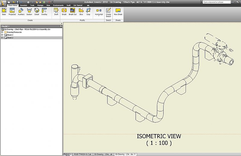

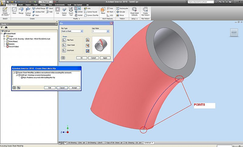

CAnnondale Posted May 17, 2010 Posted May 17, 2010 Hi Guys, Its me again asking for assistance. I have this sort of a PIPE object, this is a blanket for a 10" Pipe which has a thickness of 60mm. The company I am working with is engage on a Passive Fire Protection and this is one of the fire protection. We do protect Pipelines for the Oil & Gas industries. Now, I do want to apply a RIP and Flat Pattern but, I am getting this error message. What went wrong? and how do I solve this so that, I can apply a RIP and do a flat pattern of the objects. Once again thank you in advance for the continuous support/assistance given. BTW, this part was created from an .ipt and I use a "Make Component" feature to create an individual objects. Quote

shift1313 Posted May 17, 2010 Posted May 17, 2010 Well at a first glance id say its giving you the error because it cant be flattened. That part would need to be formed and rolled into place. I would have to play with it but i would start a new sheet metal part and do a sweep and see if it will let you flatten it that way. If you know the ID, thickness and sweep angle its just a matter of two sketches. Shouldnt be too bad. Quote
JD Mather Posted May 17, 2010 Posted May 17, 2010 Contoured roll will give you a flat pattern - but in my opinion it will not be correct for this part. (Flat pattern will be rectangular.) Quote

linnmaster Posted May 19, 2010 Posted May 19, 2010 JD is right, I tried the Contour Roll with the elbow and after applying the Flat Pattern it does give a rectangular shape which is for me is is wrong. I have attached a jpg of a drawing posted from other discussion group and it should give same outcome. Correct me if I am wrong on this. Hello. I think why inventor gives the rectangular flat pattern is becasue it creates the cylinder first, then rolls the tube to form the elbow. The rectangular flat to me is correct in a sense if the elbow has a large radius and small pipe diameter and small thickness. The development you have posted takes into account the arc length on the inner elbow radius of the pipe and the outer radius. I don't think Inventor flat patterns that way. You will get a similar development to the above if you have a small pipe length with ends cut on an angle ... Quote

linnmaster Posted May 19, 2010 Posted May 19, 2010 I tried contour flange to see if it would let you revolve around an arc instead of an axis but it would not work. Canondale, im still not convinced that you can flatten that part. Countour roll has to revolve around axis. Contour flange will not work with curves, radii, arcs. Having said that, I tried modelling using loft surface between two sketches and rail, and thickened part, converted to sheetmetal, but that won't let you flatten either. :S Quote

JD Mather Posted May 19, 2010 Posted May 19, 2010 Well, I think I've done it before - I'll try to reproduce this one when I get a chance. Yep, just created again with Contoured Roll and can flatten. Quote

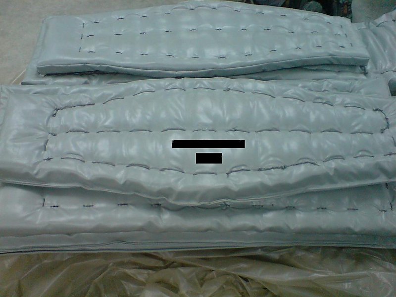

CAnnondale Posted June 3, 2010 Author Posted June 3, 2010 Since this is for a blanket (the tolerances should be liberal) you could model as faceted faces (traditional sheet metal gores) that will give you the correct flat pattern. The more faces and the more precise, but I suspect a relatively small number will suffice for the blanket. Now, let me see if my idea works... Scratch that - it didn't work. Back to the old 2d method of generating developments.... .... I haven't given up on the gore idea. Can you post a picture of a real world blanket. Seems to me it is going to have to be developed like the sheet metal gores (several pieces) or allow considerable wrinkling or considerable stretch. ...go down to the hardware store and purchase length of foam pipe insulation. Wrap around a bend - there will be wrinkling but with some tape might be good enough... Hey Guys, Sorry I was away from the computer for a while, stationed at the work site. Thank you for the feedbacks shared on this matter... JD - I have attached an actual blanket photo of the PFP used for piping. The blanket consist of a Fiber Cloth material, Mesh wire High Temp glass particles, etc... The sample image is what they call a FISH shape is used in the Elbow area of the pipes. Quote
