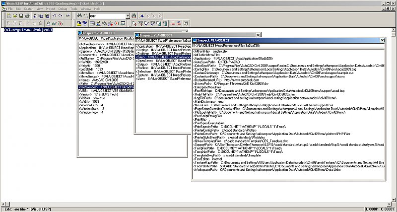

Does anyone know what is the system variable for Enterprise file path and support path and how to change the variables via LISP.
Or if that is even possible.
Open VLIDE and follow the image.
(vlax-get-acad-object)
>Preferences>Files
or you could use VLA-GET-ENTERPRISEMENUFILE to find its current value, and/or VLA-PUT-ENTERPRISEMENUFILE to change its current value

Follow the image.
eg.
(vla-get-enterprisemenufile (vla-get-files (vla-get-preferences (vlax-get-acad-object))))
(vl-load-com)
(vla-get-enterprisemenufile (vla-get-files (vla-get-preferences (vlax-get-acad-object)))"G://.../*.cui")
