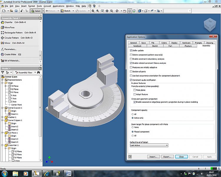

The picture shows my assembly, which is a device for measuring the angle at the corner of a window frame. The upper part rotates upon the lower part. The angle can be read from the graduations on the lower part. If the upper part rotates far enough around, it will collide with the extrusion on the lower part.
In this case, the assembly is part of a college project. I want to be as complete and accurate as I can when I submit the model, and so want to constrain it so that the upper part stops when it hits the lower part.
I've looked into the contact solver settings you recommend, and I seem to be having problems. When I select 'activate contact solver' from the tools menu, nothing seems to happen. Not even a tick next to 'activate contact solver' to indicate it is on. Neither can I find an 'Interactive contact' option as described on this page...

on the assembly tab of the application options window, as shown in the attached picture. I acknowledge that the doc linked above is for inventor 8, but the 2009 help (search for 'component collision and contact') also refers to the same option.

in the feature manager you need to right click on the name of each part you wish to make part of the contact solver. In the pop up menu down where you have Grounded, Flexible, Adaptive and so on there will be a Contact Set option. You need to tell Inventor which parts you want to include for the contact set. After you have selected both pieces(the stationary one and the rotating one), turn on the contact solver and see if that works.
If you can't figure out Contact Sets and the Contact Solver (not the Collision Detection in Drive Constraint) attach your assembly here.
