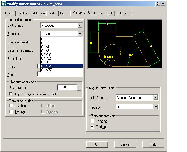

I have a problem converting my dimensions from decimal to fractional numbers and would really appreciate any help:
When I change my dimensions from decimal to fractional, its not converting correctly. For example, I measured the end of a
vice screw to be .15625 inches (the decimal conversion of the correct dimension 5/32"), but when I click on the fractional option it shows the
dimension being 3/16". It seems to think that .15625 = 3/16!!:? Do you know why this is happening?
thanks again!!
Check the precision of your primary units in your dimstyle.
that was the problem! thanks for the help I appreciate it!
