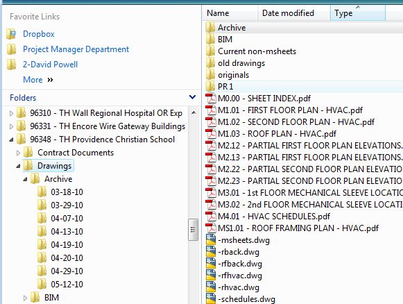

Many different ways to do this. Personally I can't stand the "rev1, rev2, etc..." file naming. Here's what we do.... when a new architectural comes in, we copy/paste the current DWG file into a folder with the current date, then move that folder into a directory called Archive. That way you increment your backups by folder date, all synchronized and then overwrite the existing file with the new architectural and bam - you're done. If you have the master drawing open, simple reload the XREF and the new changes are there. 8)

We reverse the process. The name of the current drawing never changes, that way Reference paths never have to change. When it comes to archiving we then save a copy with the revision appended to the filename...
Thanks for your help guys, appreciate you taking the time. I like the idea of just archiving and not putting a rev#/letter until it gets archived. Otherwise the xref always stays the same. However as it is tedious I do like having the latest file with a rev on it too. It eliminates any confusion or chance to overwrite it. Say I send it to the client for internal review, they already have a few archived revision copies but they also have the current. Since the file name hasn't changed how can they be sure they are getting the latest file without popping it open and checking the title block first? Or do you just have to be more careful?
My thoughts were to do what you said and when I send the file or want to release it I archive it. Then send them the file with the rev in it so there is no confusion and yet no worries with trying to re-establish link names.

Also, if you're ready for an "archive" then my suggestion to you is never archive the XREF by renaming it, but you can surely archive the master file. When you open up the master file for editing, simply do a Save As and put a "Rev 1" etc etc as the suffix of each file. Or instead of numbering them, use the current date so if your file name is "ARCH LEVEL 01.DWG" then you will name it "ARCH LEVEL 01 - REV 100520.DWG" for today's date of 05-20-2010. Naming it by Year/Month/Date (in a YY/MM/DD format) then you always will have the files ascending in the correct order from oldest to newest. This is what we do on jobs that require heavy editing and pre-design work.
