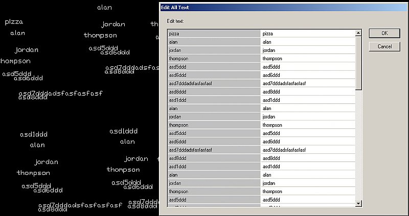

What an odd request. Fun to write...
DosLib required.

But odd is good though, i hope! Thank you for being such a team player!!! This will help me a lot in the future.
But could it be tweaked a little bit further and allow me to specify the region i want the text to be in?
Cause with this method all text is displayed, and now i have this drawing with over 700 text entries and i get lost with what i want to replace!!!
But great effort, i wonder why no one else finds this productive!
Selection method (this I kind of like)...

I also updated the original to ignore objects on locked layers.
Oh man thanx a lot, this really really helps.
