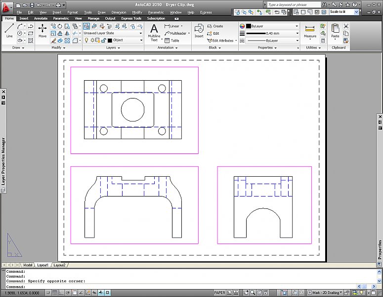

ReMark Posted May 26, 2010 Posted May 26, 2010 This is a quick but very rough example of a drawing using a layout with three viewports. Viewports can be resized using their grips even if you start with one of the built-in viewport options provided by AutoCAD. I left the viewports visible (magenta lines) so you can see there are three separate entities. All objects sit back in model space. Quote

ReMark Posted May 26, 2010 Posted May 26, 2010 Views are (from left to right) the top, front and right-hand side. You keep tripping me up by going back and forth from 2D to 3D. Which do you want to START with? Know that it IS possible in AutoCAD to create a 3D object and using any one of a handful of commands generate (separate) 2D views or blocks. I can post a layout that has multiple views created from a 3D object if you'd like. The objects in the drawing above were all created in 2D. Note: The above drawing was done as a part of a 3D class I took at a local community college. Since we had some students who had no drafting background what-so-ever in the class the teacher decided a quick lesson regarding orthographic views was in order. We quickly moved on to creating everything in 3D and using various methods/commands to extract the 2D views we required. Quote
