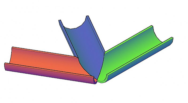

ReMark Posted May 27, 2010 Posted May 27, 2010 Different approach. I think it could be done using the Slice command and the Surface option. But until I see how the pipes are actually configured I can't be 100% sure. Well it can be done if all the pipes centerlines are at the same elevation. In the test I did I had three 2" diameter pipes at angles of 0, 60 and 120 degrees and one end of all three pipes met at the same location. Quote
ReMark Posted May 27, 2010 Posted May 27, 2010 For your consideration. Three pipes (max angle 120 deg). I sliced the top half of the pipes off so the intersections could be viewed. Quote
