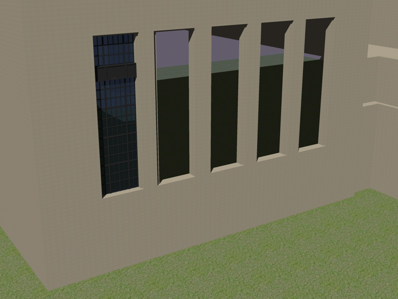

Hey guys I have a group of windows I want to render and the mullion pattern is fairly elaborate....I thought I could simply model one window, and then either make it a block or just copy it over and over but for some reason when I try either of these the copies I make do not render properly.
If I make the mullions and glass into a block they render awkwardly and if I make copies of the mullions and glass without turning it into a block, the original window renders nicely and the others render awkwardly also for whatever reason.
I'm not sure why it is doing this and if I sound inexperienced it's because I am, but hopefully there is a simple answer to this.

What do you mean they render awkwardly? What exactly is happening? Can you post one of these renders so we can see what's going on?
Thankyou for getting back to me...

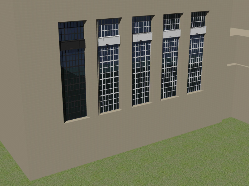

here is what I mean
as you can see, after I copy everything over the objects seem to lose there material qualitys...ideally I would just make a block of this and keep copying it...since there around 50 of the same window here

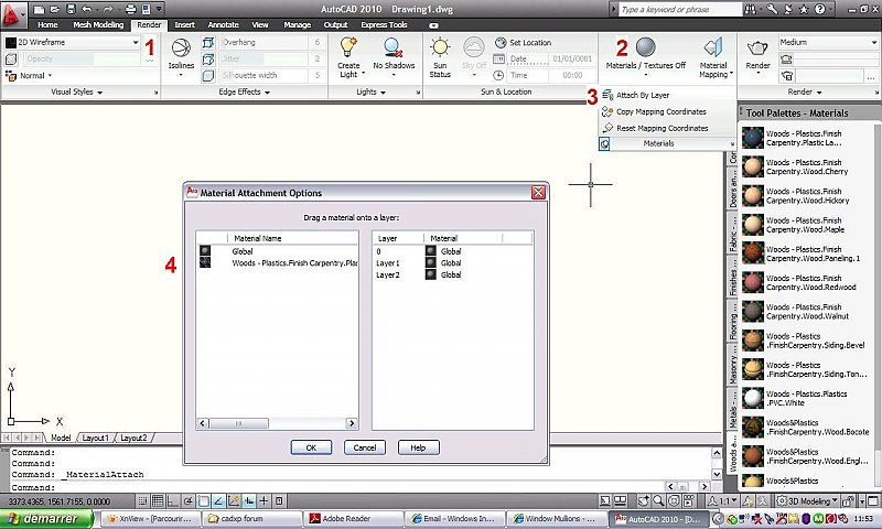

Hey, I don't know how to apply a material to a layer. Each component is on it's own layer but I apply materials by going to properties and clicking on the material tab. If there is a more efficient way please let me kNow! I will upload the file when I get home I am on vacation right now till Monday. Thankyou very much
Hi Ryan,
To aplly material by layer it is quit simple.
1st - Go to Render tab / Materials panel
2nd - Click on little arrow beyond panel
3rd - Select Attach by layer
4th - Select material on the left list and drag on layer name
5th - and ok
Have a nice day !
Pascal
This worked! Thankyou very much!!
