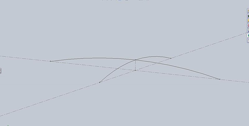

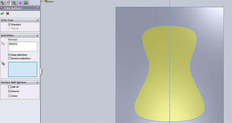

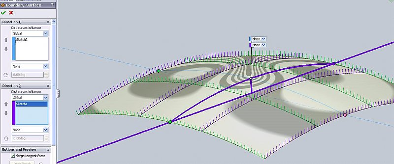

shift1313 Posted May 31, 2010 Posted May 31, 2010 Here is a picture I found online. Basically what you need to do is draw the arcs that are on the right side image. When making a boundary surface you will use one arc as Direction 1 and the other as Direction 2. Then in a third sketch you can draw the shape of your guitar body(if needed for the jig) and trim the surface. To get a solid from a surface you can either thicken it or you can create closed knitted surface comprised of several surfaces and this will make a solid. Quote

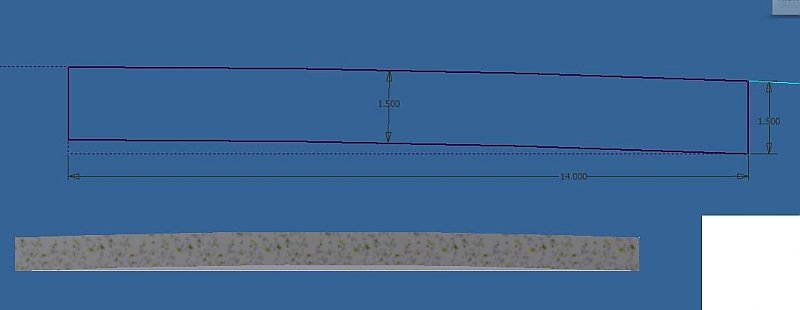

shift1313 Posted May 31, 2010 Posted May 31, 2010 Well if thats the case Dana is spot on. You will want to draw a 1/4 cross section of your radius disk and then use the Revolve function. This screen shot wasnt SW but the procedure is the same. I drew some reference lines starting at the origin. I created a horizontal line equal to the radius of the disk. Then two vertical lines. The one on the right is 1.5" tall. The one on the left will be driven by the arc. I then drew a horizontal reference line from the top of this vertical line so I could apply a tangent relation for my arc. draw the arc, add the tangent then give it the radius 336". I offset that arc and connected everything together to make a closed region. In the revolve command you will make that vertical line at the origin your rotation axis and voila. Quote
