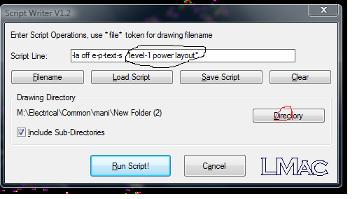

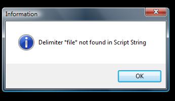

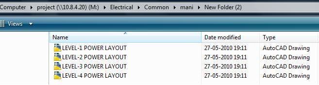

manirpg Posted June 3, 2010 Posted June 3, 2010 :cry:Dear friends, still i am finding,how its working?...........I can't find the way of executing..pls some one help me... 1. Loaded script file, using load script 2.clicked file name,edit the text (myfirst drawing placed in that directory) need .dwg? &token means? 3.clicked directory,selected path 4.clicked run script its showing error msg.......... here attached my cad screen as well as drawings stored location can any one help me?...... Thankin you:) By mani Quote
Lee Mac Posted June 3, 2010 Author Posted June 3, 2010 The drawing filenames are written to the script automatically, using the files found in the directory you have selected. You only need to include the first line of the script, and where the filename would usually be write: *file*. The token *file* represents the filename in the script - this is exchanged for each of the filenames in the directory you have chosen when you run the script. The program saves time as you don't have to write all the filenames into the script, but only select a directory to process. Example: _.open *file* _.-la _off e-p-text-s ... Let me know if you don't understand Quote

manirpg Posted June 4, 2010 Posted June 4, 2010 :(Now i understand the basic......... its Working fine with Open saveas close script...in all the dwg placed in directory. but along with this my script is not working. my need is want to layer off the "E-P-TEXT-S" layer in all the drawings. pls anyone suggest the code (script) 1.open 2.layer off 3.saveas 4.close Thanks in advance............. mani:roll: Quote
Lee Mac Posted June 4, 2010 Author Posted June 4, 2010 Perhaps try something like this: _.open *file* _.-layer _Off E-P-TEXT-S _.saveas *file* _.close Quote
manirpg Posted June 7, 2010 Posted June 7, 2010 Dear LEE,:D:D:D:D:D Now its working fine.......I am so happy while seen the success of program, then i was tried some of my own scripts. All are working. its a wonderful , amazing , superb , classic , excellent .............never end I am working one of the big project for last 2 years, so we are managing more than 500 files........at the time of submission we need to do small work (like layer off) in 100 drawings at pressure situation, that time onwards i am searching lisp like Script writer.........If i would got 2 years back, surely its save a valuable time. so now i am feeling like somebody getting life time achivement award...... Really Good one Will hope your non stop performance........ Thank you once again.. Regards mani :) Quote
