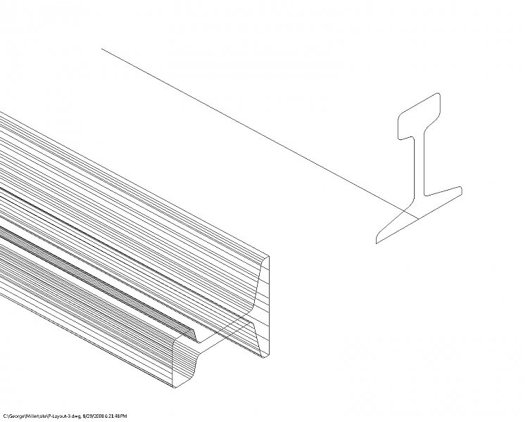

dumfatnhappy Posted August 29, 2008 Posted August 29, 2008 I'm trying to lay down railroad track and thought the sweep command is the best (only) way to achieve this. What controls the way it sweeps? see pic thanks Quote
DavidB Posted August 31, 2008 Posted August 31, 2008 correct me if i am wrong but isn't SWEEP able to do it along a path? Quote
Strix Posted August 31, 2008 Posted August 31, 2008 apparently EXTRUDE also has a path option (or am I wrong? I've not got AutoCAD to check on) Quote
dumfatnhappy Posted August 31, 2008 Author Posted August 31, 2008 apparently EXTRUDE also has a path option (or am I wrong? I've not got AutoCAD to check on) strix you rock! I extruded it along a path. outstanding. many thanks! Quote
Strix Posted September 1, 2008 Posted September 1, 2008 so now tell me the difference between the two coz I don't know and don't have AutoCAD to play with! Quote
dumfatnhappy Posted September 1, 2008 Author Posted September 1, 2008 not sure really, all I know is the sweep went goofy and the extrude (along a path) worked like a charm. Like I said.... I'm just learning this solids thing. thank you Strix Quote
