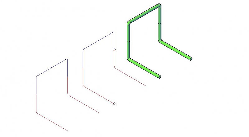

ReMark Posted June 2, 2010 Posted June 2, 2010 I think this is what msasu was referring to. Difficult to see perhaps but the legs on both sides are red and the top portion is blue. Basically I've drawn only half the pipe in two locations so I can utilize the fillet command. Since one leg was the same as the other I just copied the extruded pipe. Quote

CAD89 Posted June 2, 2010 Posted June 2, 2010 Or you can Extrude faces after each path! What I mean is that you use the Extrude command from the Solids Toolbar and then you Extrude the face like I did in the drawing bellow: Quote
