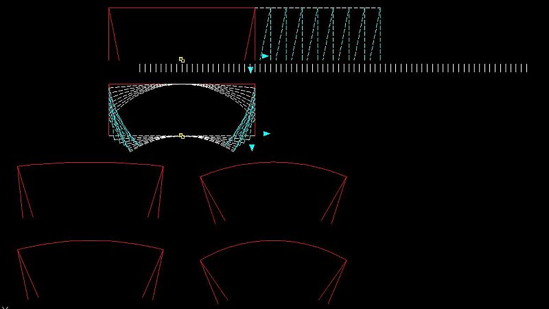

I have came to the conclusion that creating Dynamic blocks for the most part are easy. now I need to push it to the next step.
this might be both Lisp and Dynamic block
it is easy to create a dynamic block that you can stretch to set measurements but, I need to create a dynamic block that can stretch along an arc.
it has to let me select the arc, line or poly line to determine the radios.
anyone know? :?
Could you post an example drawing of what you want, the question is a bit vague.
afaik stretching along an arc is not possible but there might be workarounds.
definitely not possible with dynamic actions, maybe ask in the lisp forum?
