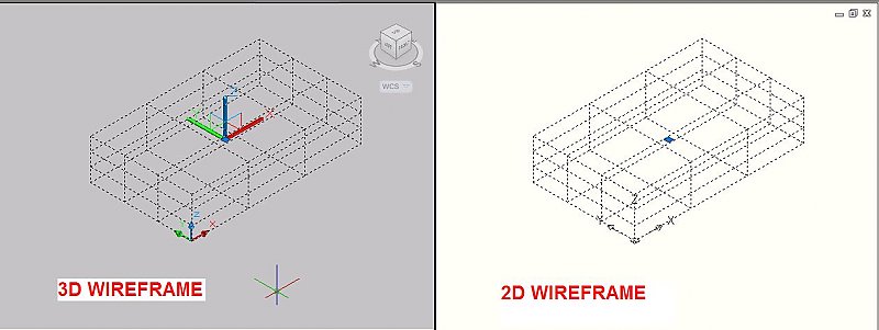

What is your shademode?
Hi,
Change your visual style to 3d wireframe
Home tab/View panel/select 3d wireframe
see the differente between 2D and 3D wireframe
In 2D no gizmo see image below
bye
Pascal
Thanks very much for that guys that worked well.
