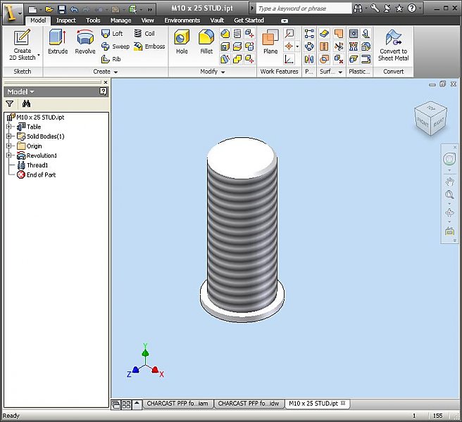

I have another query. I have a part that is always been use in our projects. It is called "CD STUDS" Capasitor Discharge Studs. Since, most of the project we use more than 100 CD Studs and would be easier for me if I can just put it on the "Place from Content Center".
How do I do it. Let say I want to put it on the Fastener+Bols = name it CD Studs.

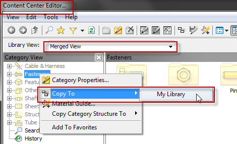

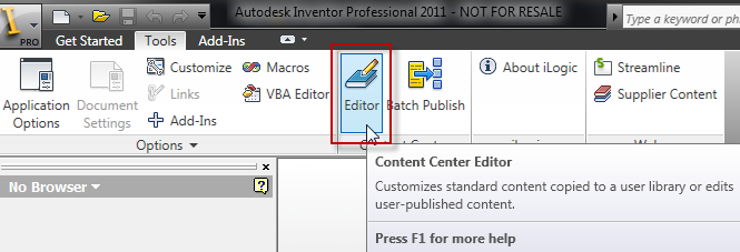

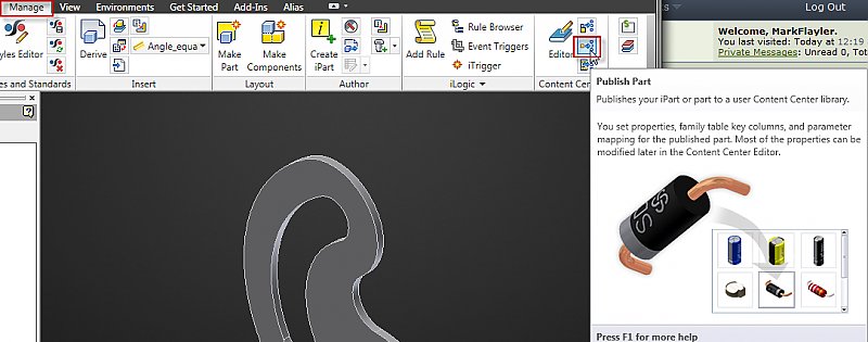

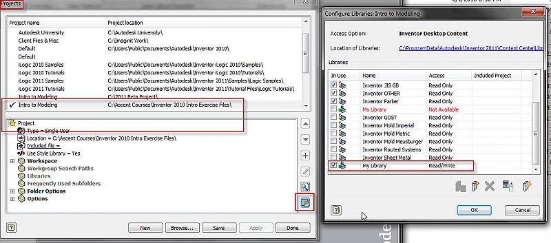

Step 1: Make sure your project reads that you have a writable library, if not create one.
Step 2: Go to your CC Editor in Inventor
Step 3: Copy the Structure of your existing library over to the writable library (usually called My Library)
Step 4: Start the Publish Part command in your part to add it to the Fasteners Category

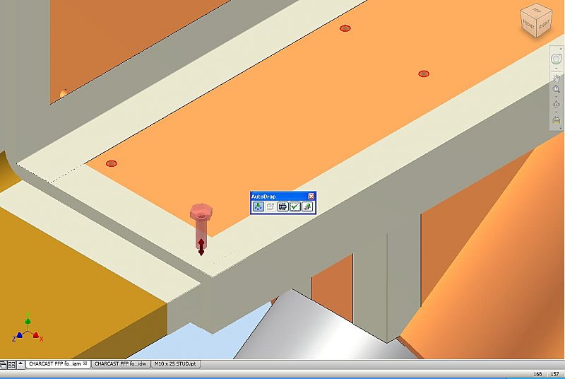

@Mark - Thanks for the assistance. BTW, after I invoke the Publish Part and add it to the Fasteners Category "I was succesfull). I did tried to Place from Content Center feature but, it does not allow me to do the "AutoDrop" functions. How do I make it to have that functionality.
I have attached an example of the "AutoDrop" function I was referring too.
The Autodrop functionality only works with iParts that are configured EXACTLY to match the category parameters of the Content Center category structure that they are assigned to. So if you made your own bolt and placed it into a folder other than fasteners or didn't properly publish the ipart for Autodrop (actually sort of difficult), then the functionality will not exist.
