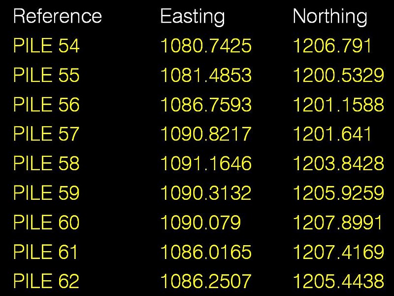

I currently have a basic lisp routine which will place a point (node) at a picked position and then schedule the points until i end the routine. This works fine for coordinates of houses or foundations when there are lots of them.
(coordinates.jpg)
However, i am looking for something slightly more automated. The problem is that when a house is moved for example i have to re-pick and re-schedule all the points again.
Is the field command a possibility? When using fields in autocad I can obtain the coordinate from a point and display it. When the point moves, the field updates.
Its there a way of incorporating this into a lisp routine? :huh:
