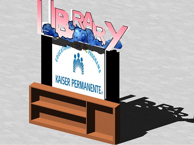

Thanks for your help. I can't seem to find a "Fit to object", is that the same as "fit to gizmo"? However, I did have some success with the planar mapping. (SETUV) I've attached a rendering of the object. The "Library" header is the object, and there is a painted rendering of that object which I need to attach to the surface. This is as close as I could get it...Thanks again.

the perspective is stretching the 3d model differently than the map itself.
I suspect that the map width is off. The map isn't reaching the furthest point of the "Y" or even properly covering the width of the stem of the "L"
Are the letters on different planes?
If this were my rendering, I'd make the pink gradient as one map that I apply to the whole thing.
Then I'd make a blue cloud map (a repeating tile) and make the clouds a seperate solid item.
Then I'd offset the edges of the letters (or recreate them) so that there's a seperate solid that makes up the black outline.
It'd be slightly more rendering time, but you wouldn't have any of the placement issues you're having now.

I would just create a flat plane, slap the "Library" texture on it and then add an Opacity map.
Yeah, that's the best method. I'm on 2004 and didn't realize AutoCAD was doing that now.
