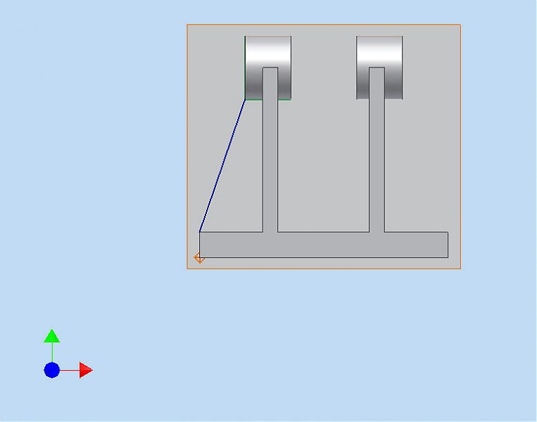

Can anybody help please?
When I try to create a rib(see drawings) I get the following message.
Self intersecting loop found in this profile.Remove the intersection by adding a sketch point at curve intersections or by changing non profile geometry to construction geometry.
After slicing the graphics,using the project geometry tool,I select the front edge of the cylinder,the bottom edge of the cylinder,the long vertical line and the short horizontal line connected to it.
I then draw a line(profile line)between the intersection of the front and bottom edges of the cylinder and the top end of the base.
Return,select rib,select profile line.Then I get the message above.
Hours working on it today.
Help please
Managed to sort that problem out .

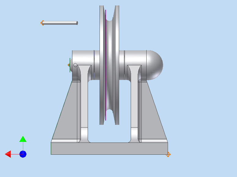

How do I align holes on main bracket and round head pin to insert cylindrical pin shown.
Thanks
Use a INSERT CONSTRAINT, or standard mate constraint. Yopu should also be in an assembly and not in a part file.
