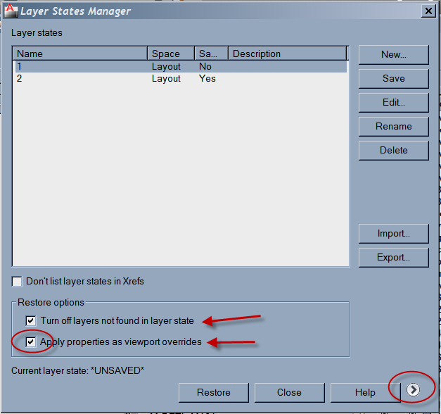

Check your layer manager for the settings shown in the attached. My guess is one of these is unchecked.

Not sure if this is where you are going wrong, but it sounds like you might be fooling around with layer visibility between layouts.
You should have all on and freezing only the ones you don't want in an active viewport in an active layout.

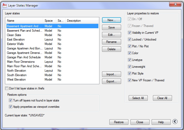

so here's what my layer states manager looks like (attached)
how would i decrease the size of my actual dwg file so that I could upload it here? I could email it to you if that would be alright?
So this was it, I knew it was probably something simple and I was just having a disconnect with how i see something working and how Autocad functions.
