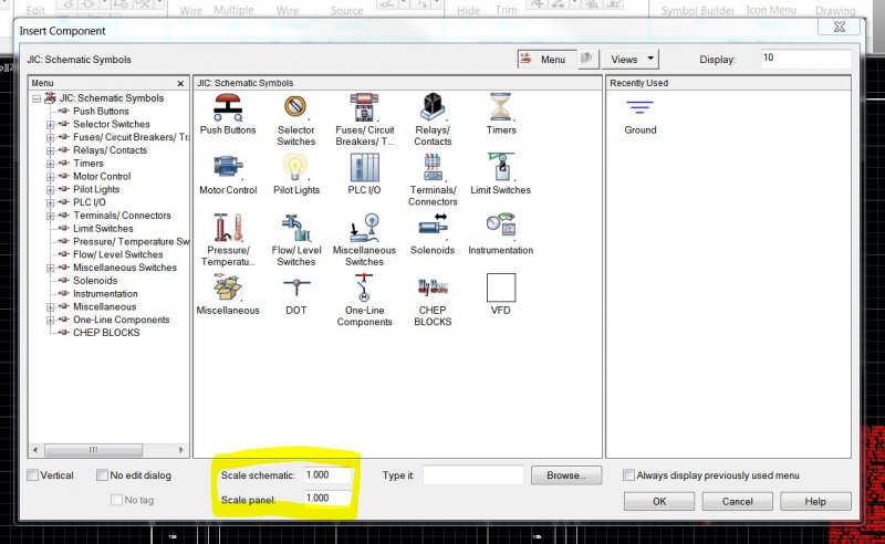

There is one thing you can check;
The insert component dialog box. Make sure your scaling is set to 1
See Below;
I hope this helps...
