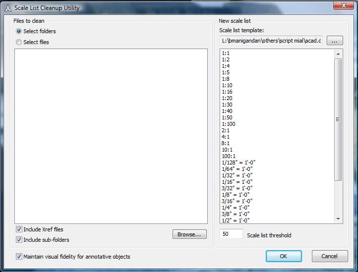

Last 2 year I am also facing this problem daily.
But I am having clean up exe file in my desktop.
so i can reset scales at a time all the drawings....better u ask ur ISD.
any way I cant do others drawings.........so hope ur request...
If u find pls share...i am also waiting to share if find
Funny this came up. We are having the same issue after we switched to 2008. This is an old bug that's been fixed back in 2008. Make sure you have the latest service pack installed and hotfixes. If you are like us using 64bit vista and can't install the updates, then you should make those commands into a lisp and make it run at startup like you said AND run it after you insert or reload an xref. That's because it re-inserts the xref scales after each xref is inserted/reloaded. The scale list just rebuilts up again!
pls help us some one having suggestion..........
Thanks
mani
