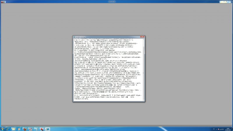

e_edram Posted September 4, 2010 Posted September 4, 2010 My problem is different, I cannot access to the activate screen. Here it is the image Quote
ReMark Posted September 4, 2010 Posted September 4, 2010 Unfortunately the image is nearly unreadable at least to me. Have you contacted your authorized AutoDesk reseller? Quote
Ile Posted September 18, 2010 Posted September 18, 2010 My problem is different, I cannot access to the activate screen. Here it is the image[ATTACH]22876[/ATTACH] Hello, any solution for this problem ? Quote
ReMark Posted September 18, 2010 Posted September 18, 2010 What language packs have you loaded? Quote
Ile Posted September 18, 2010 Posted September 18, 2010 Brasilian Portuguese, but I try in english too. Same problem. Is there any tip to completely uninstall ? Quote
Cad64 Posted September 18, 2010 Posted September 18, 2010 Is there any tip to completely uninstall ? http://usa.autodesk.com/adsk/servlet/ps/dl/item?linkID=9240617&id=2887771&siteID=123112 Quote
ReMark Posted September 18, 2010 Posted September 18, 2010 Some users have found that a complete uninstall/reinstall does not solve the problem. I think it has something to do with an entry in the Registry that remains even after the uninstall. Find a reputable Registry cleaner (see PC World). Uninstall > create a Restore Point > run the Registry cleaner then reinstall AutoCAD. Quote
