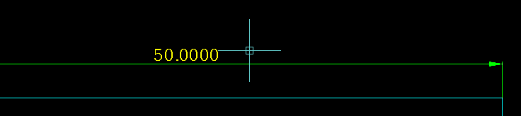

Example:
[ATTACH]20649[/ATTACH]
awesome, ya i have NO IDEA what happened, but i just reloadded it and it works now {weird, never changed anything}
i know im being picky and btw, VERY grateful for your help, but can all the zero's be suppressed? i tried altering the code but couldnt' get it to work proper.
just need it to show 8" 10" 12", and 1220 (without the .xxxx)
ps; where am i editting the quotes to make the " (inch) turn to mm (millimeter) ????
i'll need to have one for metric AND imperial jobs,
there's just so many quotes in the code im not sure what is code and what is typed in your output as a quotation
