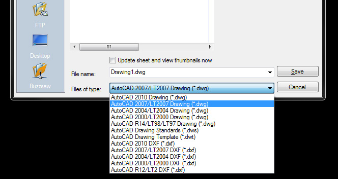

Cool thanks. Is there a special way to do it or do you just go to save as and choose 2007. I remeber doing that with autocad 2009 so I could view on 2007, all I did was choose 2008 and click save. Is that the same way?
As shown below, in the Save As dialog, for "Files of Type", just choose 2007.
You can also set your default save format to always be 2007.
Just open your Options dialog > Open and Save tab > File Save section > and set the Save As option to 2007.
