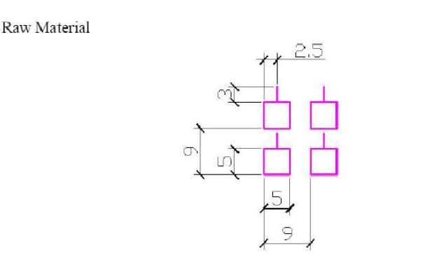

Tried various code formats to create this hatching pattern, but it still comes up as error reading when I try to insert it.
The code I used was something along the lines off
*RAWMATERIAL
90,0,0,0,5,5,-4
90,2,5,0,0,9,3,-4
0,0,0,0,9,3,-4
Any suggestions

Looking at your .pat code I found some problems.
1. Since you have a 5 Unit gap between horizontal and vertical pairs to make the shape and a 4 Unit gap between shapes you need lines for the left vertical, right vertical, bottom horizontal, upper horizontal and the stud.
2. The 3 Unit stud would need the 9 Unit offset like all the other pieces, so you would make the line +3,-6 instead of +3,-4
I still can't quite understand what you were trying to get with the third line code in there.
Here is an address that should explain it all well.
http://docs.autodesk.com/ACD/2010/ENU/AutoCAD%202010%20User%20Documentation/index.html?url=WS73099cc142f4875513fb5cd10c4aa30d6b-7e2c.htm,topicNumber=d0e368764
To tide you over, here is a code that should succeed at the hatch pattern you specified.
*RAWMATERIAL, RAW
90,0,0,0,9,5,-4
0,0,0,0,9,5,-4
90,5,0,0,9,5,-4
0,0,5,0,9,5,-4
90,2.5,5,0,9,3,-6

I think you need additional lines of code to allow for the spacings, ie if the squares and gaps were both the same dims three lines of code would work.
Try:
*RAWMATERIAL
90,0,0,0,9,5,-4
90,5,0,0,9,5,-4
0,0,0,0,9,5,-4
0,0,5,0,9,5,-4
90,2.5,5,0,9,3,-6

Hi Chris,
Just take a time to translate my teach support and some reply yet.
Well see the image

I Tried all of them and still getting an error, even with empty line
Hi Chris,
Strange have you got the same name of file and your hach ?
and when I said empty line you just have to type enter at the end of your last line and save like that
and if you really dont fix your problem, try my hatch pattern attached
Pascal
RAWMATERIAL.zip
Thanks alot, finally got it working, It must have been the file name
