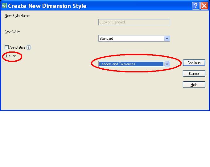

You could make a Child dimension style for leaders
Thanks again. Will try it. I'm guessing both dimension styles can be active simultaneously in the same drawing or do I need to change to the child dimstyle, when I'm doing leaders?
