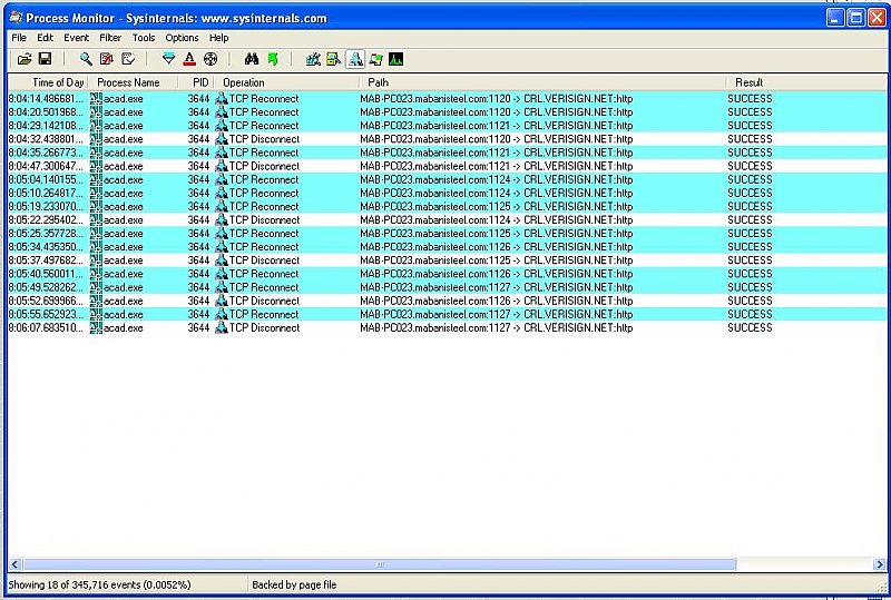

Whenever we are opening New AutoCAD, it struggled at 98% and wait for 2 to 3 minutes to complete the process.
1. What it is doing at 98% of loading.
2. It is not happening in all System.
3. The AutoCAD is loading From New work.
Please give me your feed back..
Regards,
Muthu.

As mentioned, most likely AutoCAD is looking for something it can't find. Non-existent paths, missing printers, etc.
Take a look at this, it may help you track down the issue:
http://cadpanacea.com/node/71
Thanks a lot.
I have used that tool and i noted that it is trying to do something. But I can't understand.Refer attached sketch and let me know what it is doing and how can we avoid it?

Pleas refter attachment which was missed in earlier post.

Another issue could be the "start in" folder for the AutoCAD shortcut. By default that is C:\Program Files\AutoCAD 20xx\UserDataCache which is a hidden read-only folder so AutoCAD automatically ignores that and switches to your home "my documents" folder. If that folder is on a slow network connection (eg. VPN) then AutoCAD can take an extremely long time to load (e.g. 30 minutes). You can solve that by modifying the shortcut to point to your AutoCAD drawings folder.
