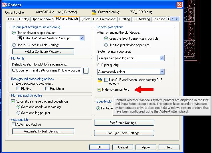

Here it is in the options:
I am not sure of what the System Variable is for use in a routine.
Chuck

Chuck - I was aware of that - I just needed to know programmatically
