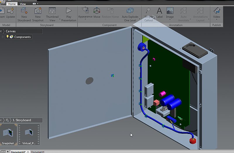

I was playing around with Inventor Publisher 2011 and tried to open an assembly I made with some wires made using harness add-in but it would not show up in Publisher 2011. Is this a short coming of publisher or I am missing something?

Something else is going on. I was able to bring in my harness design just fine. How are you bringing it in? Was the assembly full resolved before you brought it in?
I am definitely missing something. Had to uncheck "Use surfaces for all segments and wires" in the harness settings.
