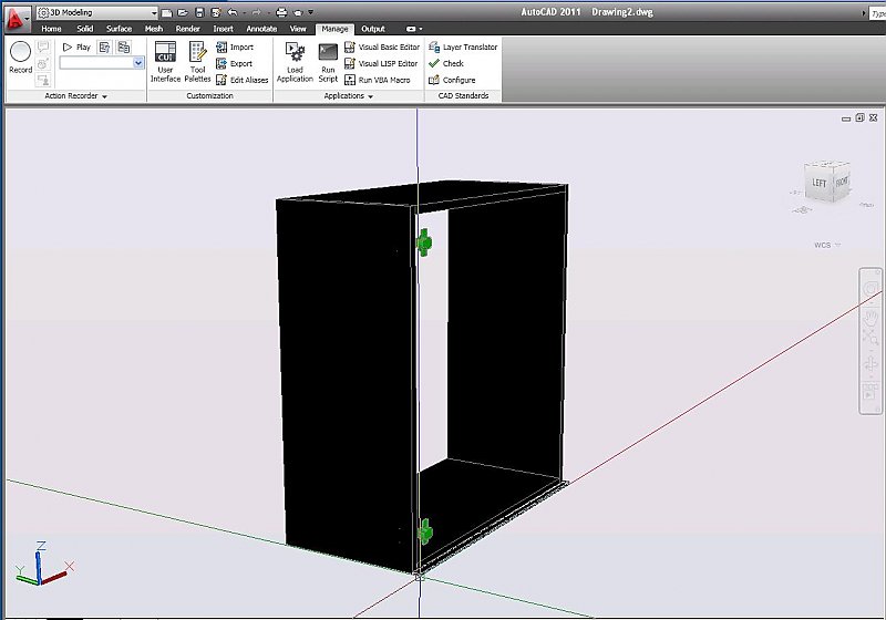

Hi,
If I get the insertion point anywere in the modelspace the lisp works correctly.
But wenn I want to click on an endpunt of excisting object in my modelspace I get an error.
Does anyone know wat could caused that?
ps1: it is going wrong wenn I try to use ip of an 3d solid! bij 2d objects it is going wel!
Thanks MR

To me it works, maybe some issue with the end point not being on the same elevation as the new front?
Bij mij werkt het... Ik weet het verder niet maar misschien heeft het met de Z positie te maken?
Yes, I also think It has to do with the position of Z.
Only is theire a command I can set the position of Z from my lisp so It wil work.

What error are you recieving? Can you post the block that your code inserts? I am finding that it all works except for not having the block to insert. I would suggest some changes to the code so that you could see what you are drawing as you enter the inputs...
Me to, I made a block myself, maybe I should not have done that...

Ok, I did found out what is going wrong, but now I have to get an code to get it work.
Bij placing an object as box by using LISP you can run the LISP pomplete correctly if you are clicking in the modelspace. After al; If you click at an endpoint of an exciting SOLID object for your insertion point the lisp does'nt work correct.
I just started to create these lisp files and I am wondering if I could get an code so I can select an endpoint as my starting point and stil run correctly my lisp file... I will attach the lisp files,
ps1: It is an tip to also load my listscharnier to get an good running of the lisp.
Greet MR
front.LSP

See my attachment. After I create the cabinet like in the file I want to add my front. I want to give my offset of the cabinet then the hight of that cabinet and the width. Then I want to insert the front by click on the position were I placed an sphere. but then it isn't working;)
Regards MR
1.dwg
I've had a chance to take a look at your dwg this morning. I believe your error comes in your polar computations. The following are changes that I have made. Try replacing the following in your code.

well I can create the front with my hingles but still can't click my ip on the corner of the cabinet.
If I click on the corner of an cabinet this lisp won't work.
did you tried to create it and click on the corner of the cabinet>?
Regards MR
Well... What isn't working for you? With the changes that I made everything works fine ( with some adjustments to the INSUNITS).
I enter the distance for the offset, the thickness, the height, and then the width. I then click the corner where you had placed the sphere and everything falls right into place, Hinges and box. I'd Love to help you but I will need to know exactly what is not going right for you.

One other issue that I am finding is that you need to open your scharnier.dwg and move the block "listscharnier" from the insert point to 0,0 and then set your INSUNITS to 4 in scharnier.dwg then save and then you need to make sure that your drawing INSUNITS are set to 4 as well. All should work then. :)
Hey! Thanks for your bet to get this done wenn I take over your code I get as result the front stays low.... I dont know what it is. I attach an image.
Are you saying that the box isn't being drawn right? What are the dimensions that you enter for the Offset, Thickness, Height and Width? I've edited the above code (in red) to print to screen the dimensions that were entered.
correct, I am taking over the complete code you changed.
Now after I load my lisp kast, I wil include as attachment, I will draw the cabinet by using the lisp kast. try to draw it.. than after I draw this cabinet I wil insert my front on this cabinet. well I use offset 3 than for hignt I click on the top corner on the cabinet and the bottom corner of the cabinet, for the widht I click on the left bottom corner and the right bottom corner, than click my insertion point on the left bottom corner...
I really not knowing why it draws the front that low....
Regards MR
kast.LSP
