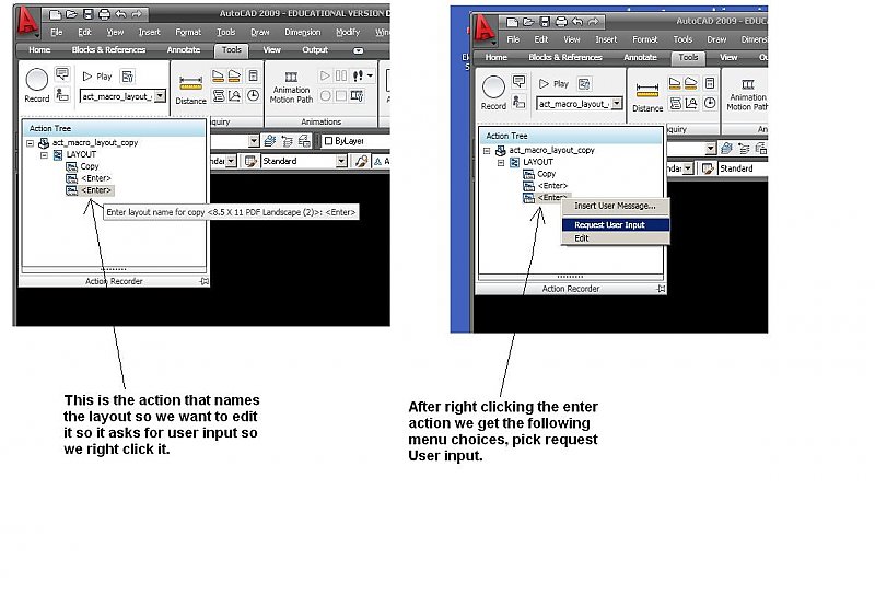

Skybeorn Posted June 10, 2010 Author Posted June 10, 2010 Sure, 1. Open AutoCAD. 2. Create the layout you want to use. 3. At the command Propmt type ACTRECORD 4. At the command Propmt type LAYOUT 5. At the command Propmt type COPY 6. Enter the name of the layout you want to copy hit ENTER 7. It will ask you if you want to rename the layout, hit ENTER 8. At the command Propmt type ACTSTOP 9. Give your recorded action a name (something you will remember)act_macro_layout_copy, then hit ok on the dialog box. 10. Now that we created the action macro we need to edit it to prompt the user for layout name. 11. Go to tools on the ribbon ( see first screen shot) 12. Follow instructions on second screen shot. 13. After you have checkmarked request user input it's time to run the macro. 14. You can click the play button on the action recorder, or at the Command Prompt you can type the macro name in this case act_macro_layout_copy 15. After that just hit enter and go crazy! *_* Quote

Skybeorn Posted June 11, 2010 Author Posted June 11, 2010 Tiger, I thinked you forgot to post the second screen shot? Quote
