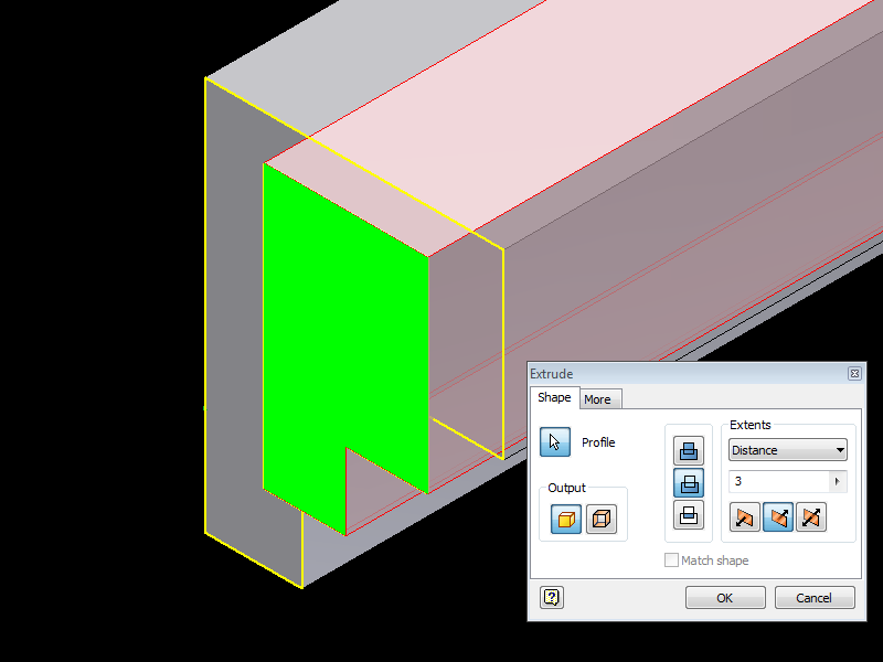

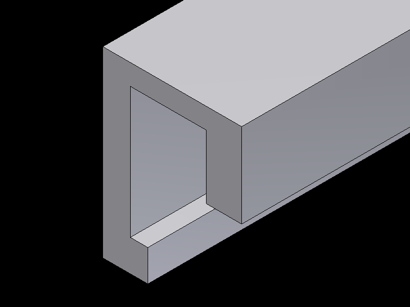

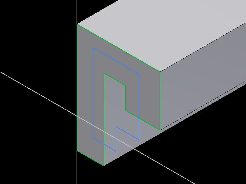

Well, you could use the profile, (sketch) of one to cut the other. Copy the sketch of the part you want to slice with into a new sketch on the part you want to cut and use the Extrude/Cut option...
A simple example:
The blue sketch is a copy of the part I want to fit my existing
Extrude/Cut
Now I am sure these parts will fit perfectly in my assembly.
